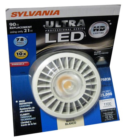

Sylvania PAR38 1100 lumen Review
Post by mediatechnology » Mon Oct 17, 2011 10:59 am
I decided to use to replace a pair of outdoor CFL floods with some new Sylvania 1100 lumen LEDs.
Sylvania LED21PAR38/DIM/P/930/FL/HVP
Sylvania Ultra HD Pro-Series LED Lighting Catalog
This is my Lowe's review on the new Sylvania PAR38:
I've been using the Sylvania PAR30, PAR38 and MR16 LED lamps indoors for a number of months now with great results. All produce clean, 3000K light and dim well with a wide variety of dimmers. I decided to replace a couple of outdoor CFL par-series with the Sylvania LED21PAR38/DIM/930/FL30/HVP offered here as Lowe's SKU 352309.
The GE FLE26/2/PAR38/XL is a 1300 lumen CFL "warm white" that has been in service for almost two years now. My only real complain about the GE is slow warm-up time and low output when very cold. When you turn on the GE, be prepared to wait about 3-5 minutes for useful light even on a warm day.
Now that the Sylvania LED21PAR38/DIM/930/FL30/HVP LED is offered in 1100 lumens I decided to give it a try. Wow. The light is stunning and of course there's instant turn-on. The GE CFL was a 40 degree beamwidth, the Sylvania LED21PAR38 "FL30" is 30 degree. The LED appears visually much, much brighter and the 3000K color temp makes the colors in the view of our woods just "pop."
The LED21PAR38 does dim. Operation on a variable AC voltage Variac begins with a mild "pop-on" at about 30 volts rms. Using it with MLV (magnetic low voltage) dimmers I doubt this will be an issue. It hasn't been with the other Sylvania PARS. This lamp also works on DC. Measured consumption at 120V was 30VA. I suspect the 21W figure reflects the lamp's power factor. At 60V, with lots of light still being produced, this lamp drew only about 1.2W.
