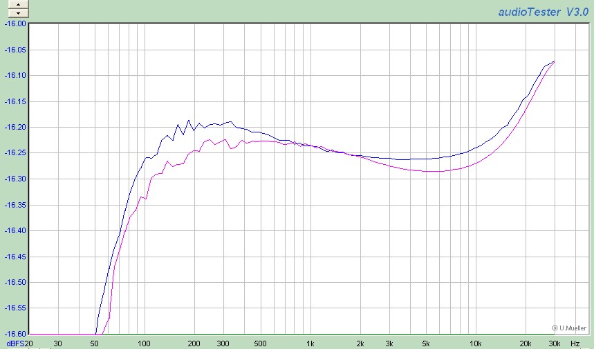

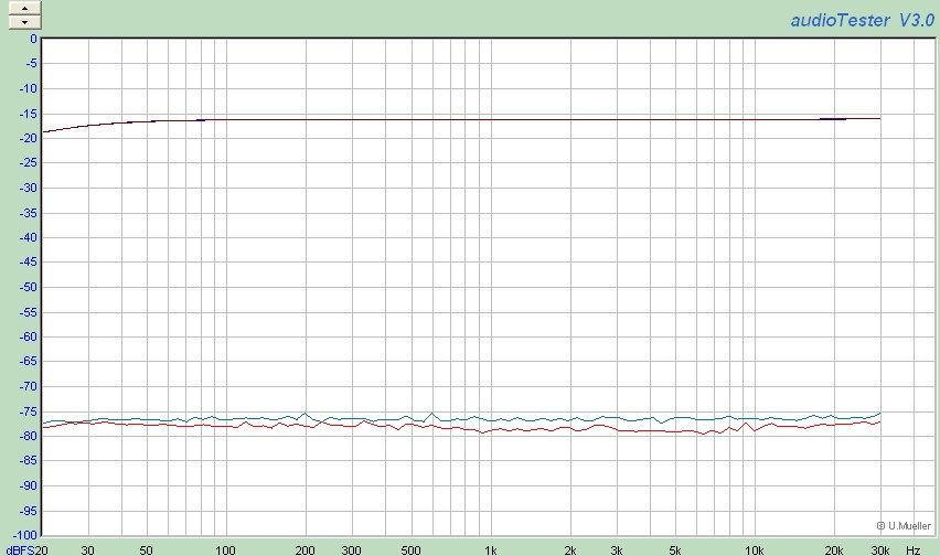

Post by mediatechnology » Mon Oct 05, 2015 8:29 pm
I was testing a unit today and ran some curves using the Lipshitz/Jung inverse RIAA network published in the TAA, 1/1980 issue.
(See: "A High Accuracy Inverse RIAA Network," The Audio Amateur, 1/1980. http://waltjung.org/PDFs/A_High_Accurac ... etwork.pdf)
The inverse RIAA network feeding the preamp is based on figure 3 without padding.
The first curve is the overall RIAA response curve with each channel individually driven.
The left and right response curves overlay.
Plotted with the frequency response curve is the interchannel crosstalk clearly below the noise floor.
Phono Transfer System RIAA Frequency Response and Inter-channel Crosstalk
The subsonic response deviates from RIAA. The LF rolloff is user-selectable using the gain jumpers.
The following curve is the inter-channel RIAA equalization error.
I suspect that the rising response in the top octave is both an error in the inverse RIAA as well as analyzer filter error.
Phono Transfer System Interchannel RIAA EQ Error
The maximum inter-channel response difference is about 0.05 dB at 200 Hz.
