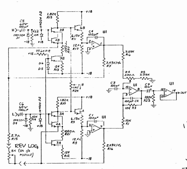

In March of 1984 I visited Al Burdick of Benchmark Audio in his garage in Garland, Texas. Al gave me a hand-sketched drawing of a preamp he had been working on and was really pumped about the Rohm 2SB737. I recently found the schematic:
Note the date: March 1, 1984.
I had been led to believe that Cohen "invented" this topology and looked up his AES paper. It was presented in September 1984. Cohen characterized this preamp, with the op amps wrapped around the transistor (provding both AC and DC feedback) as "new." Now if Cohen presented it as "new" in the fall of 1984, how is it that Burdick was able to sketch it in March?
Hmm. Something isn't adding up.

Yes it was known as far back as 1968.
"Evolution from Operational Amplifier to Data Amplifier," Robert Demrow, Analog Devices, 1968. https://www.proaudiodesignforum.com/for ... =12&t=1052

Interesting early reference,,, Looks similar.
I wonder about the value of collector resistors for input pair, and a little more clarity on the internal gain stage (UNITY CM GAIN).
Putting the variable gain in second stage is not optimal for S/N. but it looks like they were more concerned with CMRR.
Indeed close enough to claim priority.
JR

Notice the shield drive line from the derived CM. Not much of a stretch I suppose to use it to bootstrap the input bias resistors.
I find it interesting that INAs were once called "data amplifiers." We hadn't landed on the moon when this one was published. I was 11.
One thing that is unique about Cohen (at least based on what I've found so far) is the fully-balanced topo from "in" all the way out.
