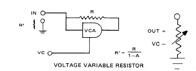

Something about seeing a backwards VCA feeding it's own input bothered me. I didn't immediatley see what was going on. Since the THAT and SSM VCAs are current in/current out I took a closer look at the 1537.

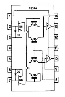

OK, so the Aphex 1537 is current in voltage out. But the simplfied drawing still doesn't make sense. What we want is a voltage-variable resistor.
OK, still odd-looking but closer examination of the resistance versus gain equation shows that the resistor is being bootstrapped by the VCA.
OK, I'm starting to get it. We have a voltage in/voltage out variable gain block which is overall non inverting. We take a lower-valued resistor and by driving the opposing end with the same polarity we synthesize a larger one and put the whole gizmo under exponential voltage control. Cool!
1) When the VCA is in full attenuation the value of the resistor is unchanged and the "ground" end held at AC ground.
2) When the VCA is precisely at unity gain the value of the resistor approaches infinity. (Well, almost.)
3) When the VCA gain is greater than one all hell breaks loose. (I discovered this in test.
So we've got some pretty good dynamic range (of resistance change) available under voltage control.

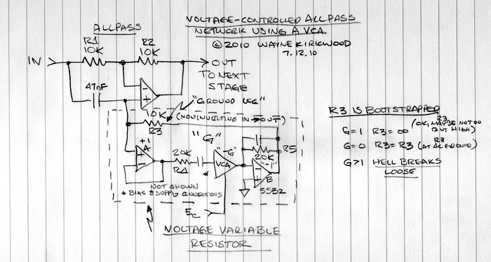

Note: The following schematic is an earler topology which has since been abandoned in favor of this one: viewtopic.php?f=6&t=368&start=31

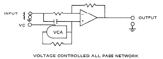

The above is a simplified single all-pass network. I cascaded three of these for the demo. The outputs are sum/difference and one is polarity inverted. (I did that for maximum mindf**k.) Control of the demo was done manually and the unit has a good CV vs effect "knob feel" with a linear CV.
R3 is the voltage variable resistor with the "ground" end driven by the bootstrap. An input buffer is required to isolate R4 from R3 permitting a large change in delta-R3. Though not as elegant as Neil's modified all-pass topology (this one uses one more op amp per stage) the THAT2180 should outperform the SSM2164.

John: I found another cite for an SSM2164-based phaser and it looks like the Cfb around the I-V converter were made bigger so that it acts more like a voltage variable integrator: http://userdisk.webry.biglobe.ne.jp/000 ... ph0505.GIF
From looking at the all-pass network, doesn't it look like an SSM2164 paired with an I-V is inverting overall? Notice how the VCA output is summed back in through the inverting input.
I think the 30K feedback from the VCA out back into the SSM2164 input current node is a trick they don't show in the datasheet to alter the gain response. If you look at the voltage-controlled panner figure in the original SSM2018 datasheet you'll see something like this. http://www.analog.com/static/imported-f ... df#page=12

One thing I learned from yesterday's experiments is that BIFET op amps may indeed be a better choice for the two which connect to the left-hand side of R3. In my prototype I went "all bipolar" (NE5532) thinking that the circuit impedances would be low enough. At DC they are. But when R3 becomes R3' due to bootstrapping the AC noise current of the 5532 becomes significant. With R3' in the megohm range at AC, Inoise * R3' makes for an interesting 1/f demonstration. The sonic character of the noise floor is rocky to say the least. When R3 is in the low range the circuit is very quiet. The answer of course is to use BIFETS with low current noise. Other than cheap stomp boxes using 4558s you almost always see TL074s in the all-pass. This may be why and my first circuit used a TL074 all-pass. I think the voltage followers that buffer the VCA input also need to be BIFET since they "touch" R3.
So R3 may look to be 10K but it's not due to the magic of bootstrapping.

The gain cell is the variable R in a MFB LPF... below cut off in the passband the 10k R feeds the output, and the signal gets LPF the output is controlled by the dry 20K and signal roates through 180' of phase shift.mediatechnology wrote:John: I found another cite for an SSM2164-based phaser and it looks like the Cfb around the I-V converter were made bigger so that it acts more like a voltage variable integrator: http://userdisk.webry.biglobe.ne.jp/000 ... ph0505.GIF
yes gain cell is non inverting, looks like voltage input, not current input.From looking at the all-pass network, doesn't it look like an SSM2164 paired with an I-V is inverting overall? Notice how the VCA output is summed back in through the inverting input.
Looks like basic 2 pole LPF topology to me, while the r in series with one of the caps is not typical and adds a zero to that one pole.I think the 30K feedback from the VCA out back into the SSM2164 input current node is a trick they don't show in the datasheet to alter the gain response. If you look at the voltage-controlled panner figure in the original SSM2018 datasheet you'll see something like this. http://www.analog.com/static/imported-f ... df#page=12
