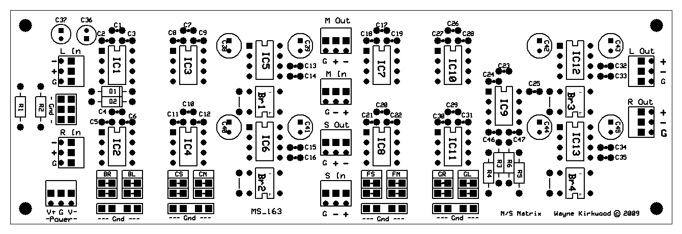

This is a stuffing guide:
Large format file: http://www.ka-electronics.com/Images/gi ... _large.GIF
The flow diagram. Note that points B, C, F and G correspond to the header connections.
Note that the Encoder and Decoder are interchangeable. For highest accuracy I recommend that the left side be used as the Encoder and the silkscreen is marked that way. For -6dB encoding, the decoder side can be used but it's far less accurate since the 1% MF resistors of the -6dB stage are in the Mid/Side Domain where they affect crosstalk. When the -6dB stage is used in the decoder, the accuracy of the resistors are far less critical since the only affect channel balance by a very small amount.
A photo might help too. Note that D1 is installed backwards in the photo. Both really point to the right and the PCB silkscreen is correct. Trust me.
Note that the 5532 -6dB gain stage, in the L and R domain, sits after the 1240 decoder between it and the 1646.

What is the orientation of the jumpers on the board? To disable the insert point is the jumper installed from one silkscreened box to the box below?
Posts: 3728
Re: Mid Side M-S Matrix Construction Information
Post by mediatechnology » Sun May 10, 2009 1:50 pm
EDIT: If I understand your question correctly, no. Take a look above. The bottom-most rows are Ground. The jumpers link vertically from insert send to insert return. To disable them just remove the jumper or store it on one pin.
Look at BL and BR for example. That's point B on the block diagram for Left and Right.
The top row of pads on BL are the Left Insert Send Out.
The middle row of pads on BL are Left Insert In. (It leaves the picture to the right.)
(There are two sets of pads for each input and output.)
Point B is Encode Left and Right Out Post-Line Receiver.
Point C is Encode MS Out.
Point F is Decode MS Out Post-Line Receiver. (Single-ended Decode Input or location for buffered MS ratio trims.)
Point G is Decode Left and Right Out Pre -6dB Active Attenuator and Line Driver.
The "Precision" bypass mode jumps from C insert send to F insert return.
